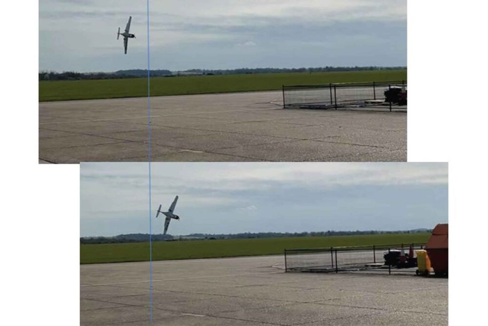

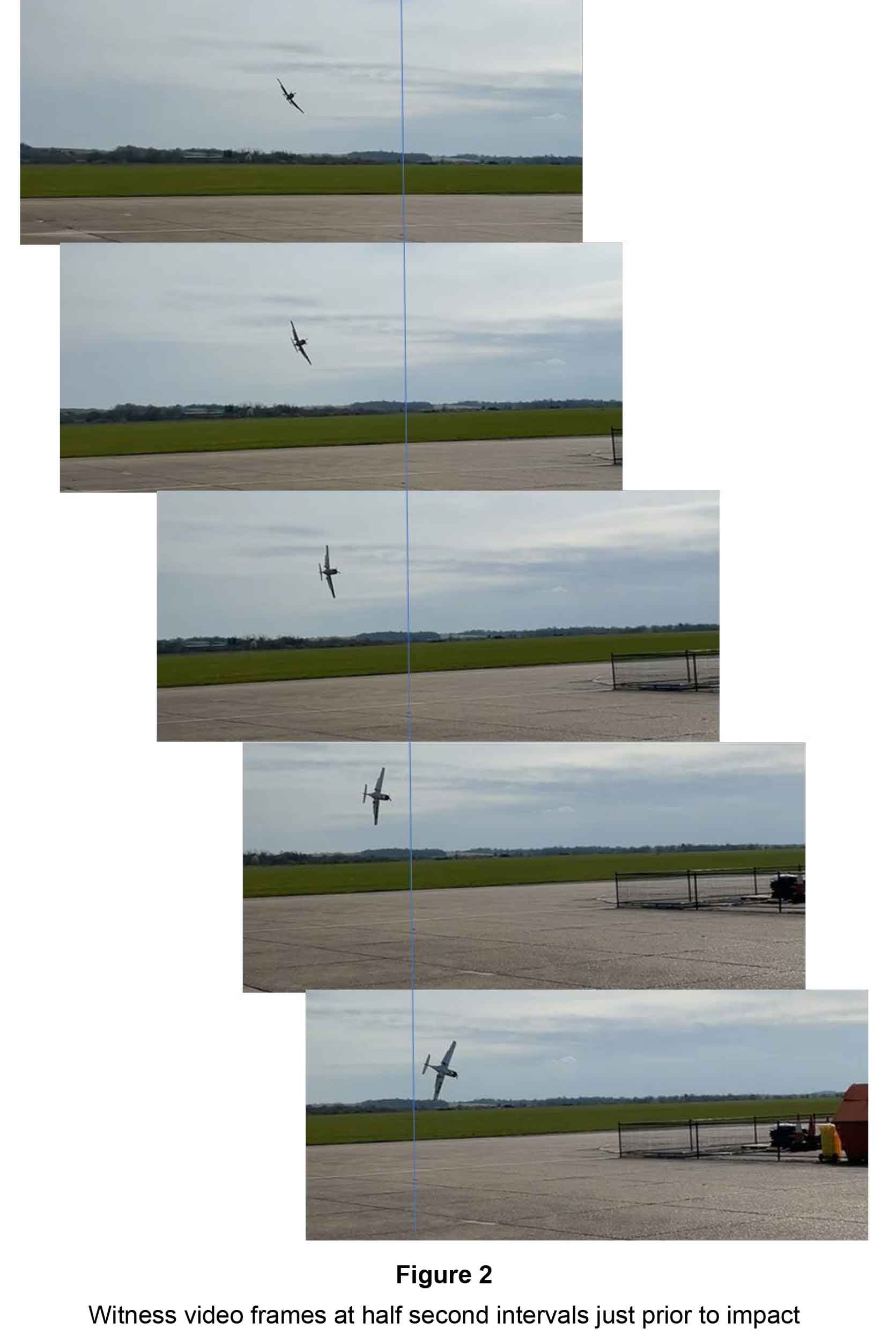

Data from onboard systems and witness video indicate that the aircraft completed two uneventful circuits before the fatal third approach. During the attempted touch-and-go, the aircraft bounced on touchdown. The pilot applied full power to initiate a go-around but failed to control the resulting aerodynamic effects. The aircraft rolled sharply left, stalled, and impacted the ground in a steep bank, fatally injuring the pilot.
Analysis of flight data showed the aircraft reached a high pitch attitude shortly after the bounce, followed by rapid power application — within 2 seconds — without sufficient right rudder input to counteract the powerful left-turning tendencies of the SR22T’s 315hp engine. The result was a sustained stall and uncontrolled yaw and roll to the left.
The aircraft struck the ground approximately 90° off the runway heading and was destroyed in the impact. Although the Cirrus Airframe Parachute System (CAPS) deployed during the crash sequence, it was not activated by the pilot but triggered automatically by the structural breakup of the cockpit.
