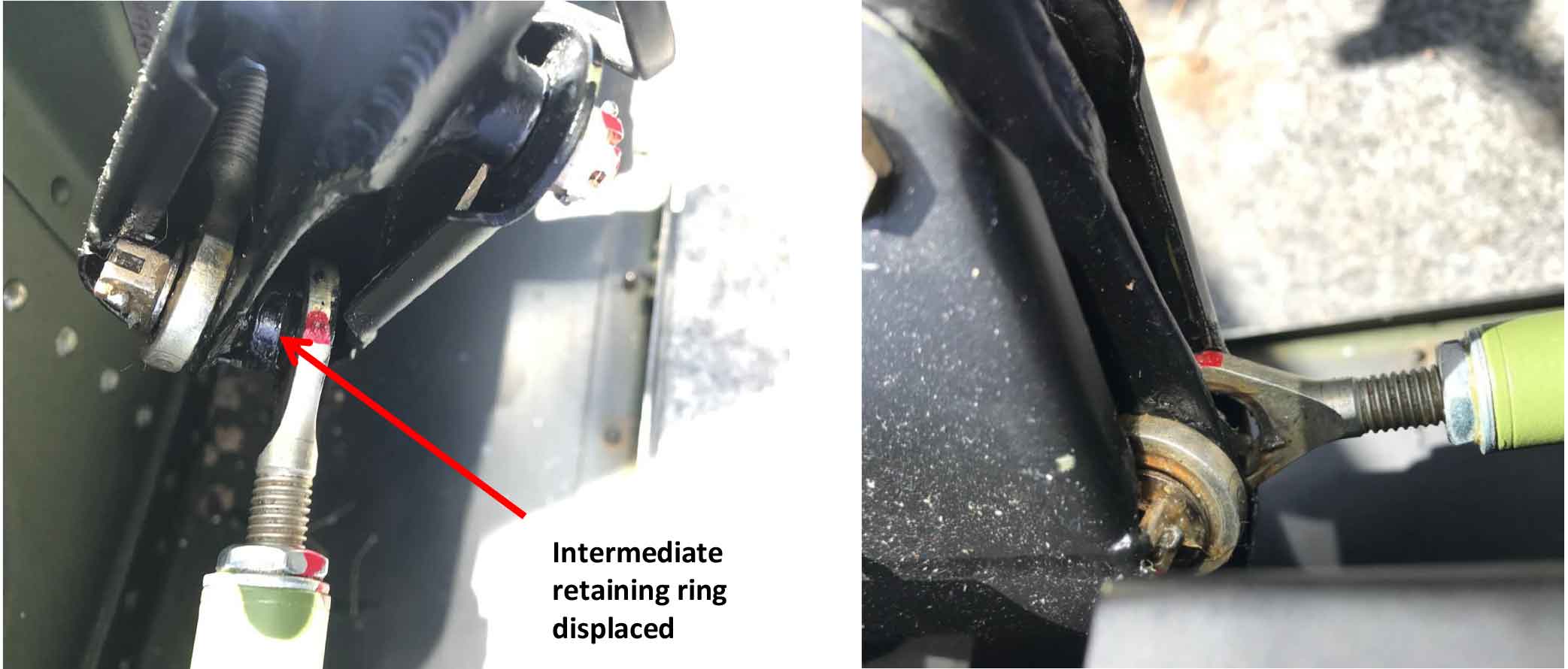

The MPD is based on a Service Bulletin issued by the UK distributor Airmasters earlier this month. The MPD says owners of the aircraft must inspect the rose joint (spherical bearing) connecting the bottom of the control stick to the aileron push rod.
A recent incident occurred where the centre of the rose joint had become displaced and subsequently jammed the aileron controls.
