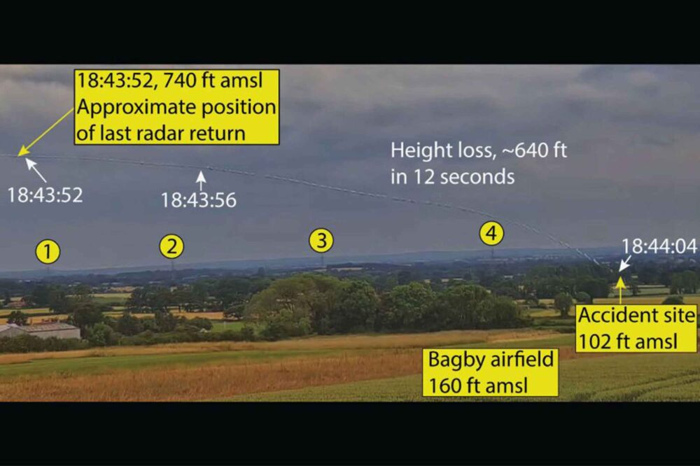

Composite CCTV image of G-BKJW descent into terrain. Image: AAIB

After the pilot made a normal radio call to Bagby to say that he was four miles from the airfield, the aircraft was seen on radar and CCTV to join right base for Runway 06.
The CCTV video showed the aircraft’s descent angle start to steepen while it was on right base. There was then a slight reduction in descent angle before the descent angle steepened sharply and the aircraft struck trees and then the ground at an angle of about 35° to 40° nose-down, with no indication that the aircraft was starting to recover.

The post-impact fire destroyed a significant amount of physical evidence, but that which remained contained no identifiable defects that could have caused or contributed to the nose-dive. The one anomaly found was the position of the pitch trim drum which was 3 mm from the full nose-down position.
