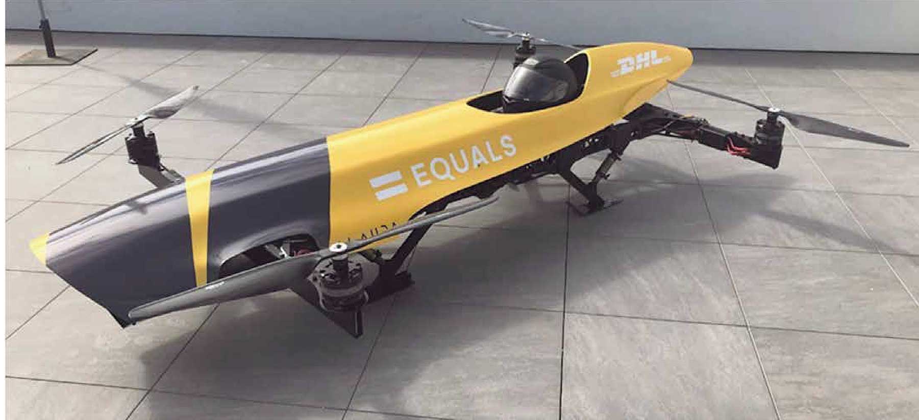

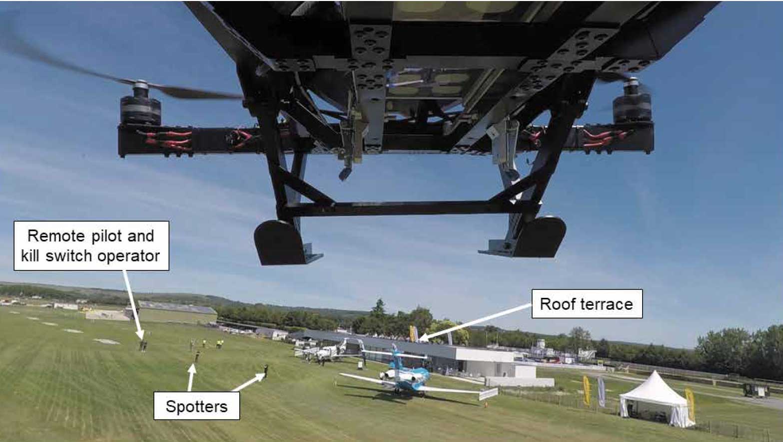

This is what happened at Goodwood Aerodrome on 4 July 2019 at 11:40 when the remotely piloted Alauda Airspeeder, a 3-metre long 95kg drone in the shape of an F1 racing car, gave a demo flight in front of a crowd of VIPs standing on top of a nearby building.

Aluada Airspeeder MkII
The Alauda Airspeeder MkII

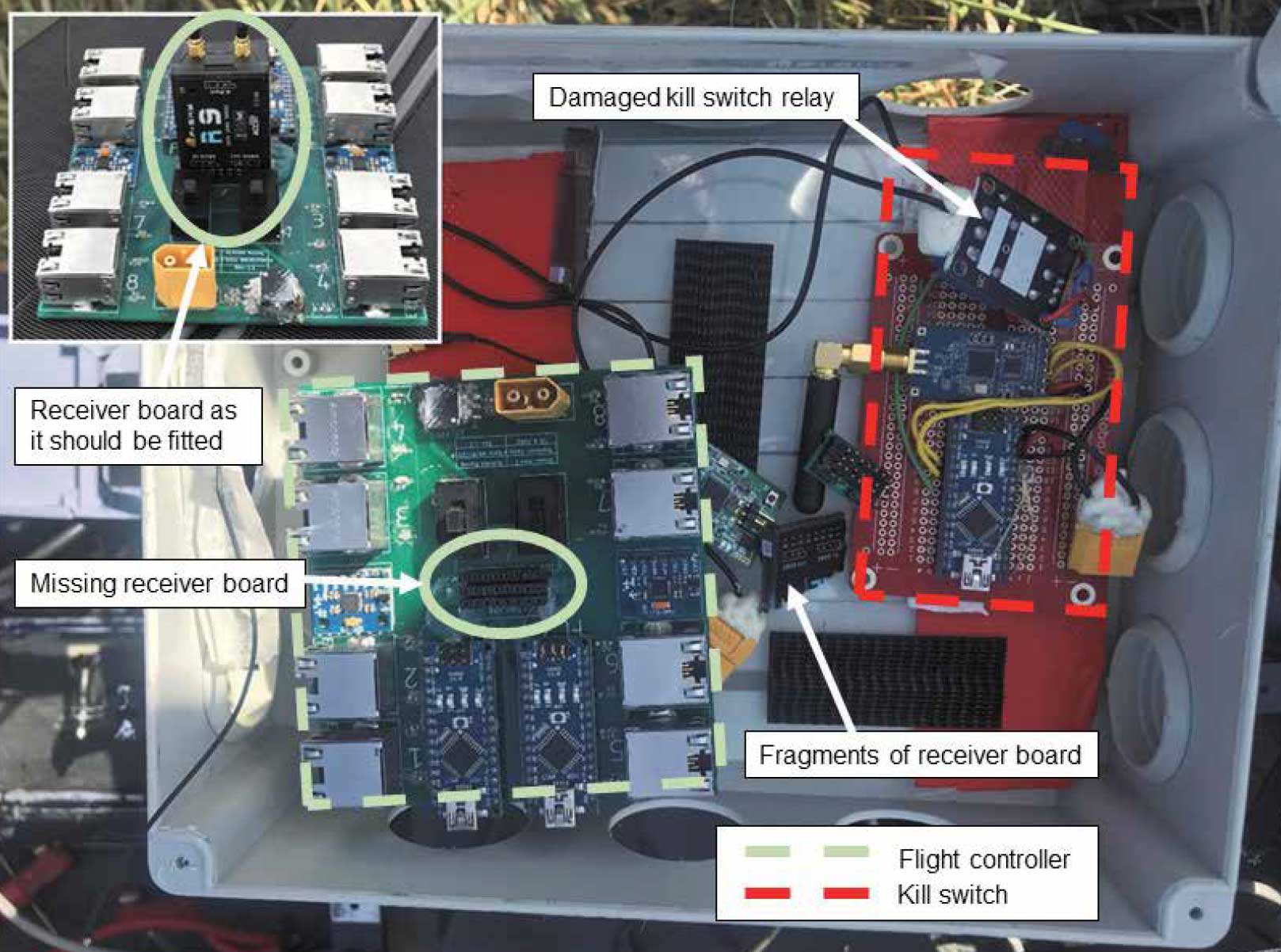

A number of issues were identified with the design and build of the Airspeeder Mk II, including numerous single point failures:
  • The assembly of the electronic flight control system failed to meet relevant standards
  • The flight control system was not capable of providing telemetry to the remote pilot
  • It was not fitted with a GNSS position monitoring system which could have enabled electronic safety measures, such as automatic return to take-off point or geo-fencing, to be used
  • There was no placarding to warn first responders of the hazards of the high voltage stored energy device (battery)
  • The Airspeeder Mk II did not have any data recording devices fitted, which would have provided useful information about the conduct of the flight

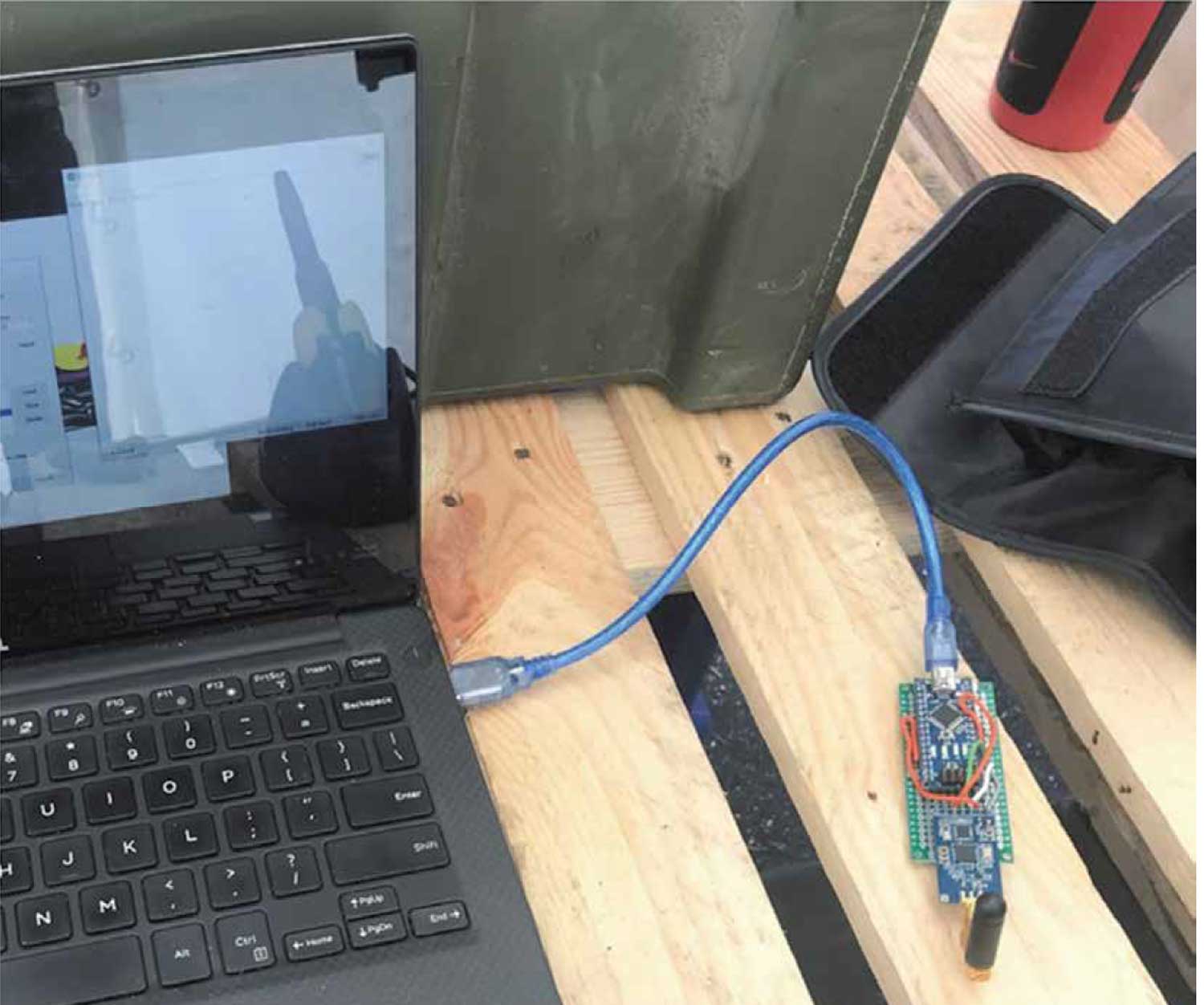

  • The electronic kill switch was manually operated.
According to the operator, the Airspeeder could not be controlled if one propeller was not working (there are four).

Airspeder demo
A view from the Airspeeder just after take-off, showing the apron at Goodwood Aerodrome. Images: AAIB

Airspeeder kill switch
Kill switch for the Airspeeder was this device hanging out of a laptop

The AAIB found the Airspeeder drone wasn’t built to any recognised standards. This is the flight controls box
