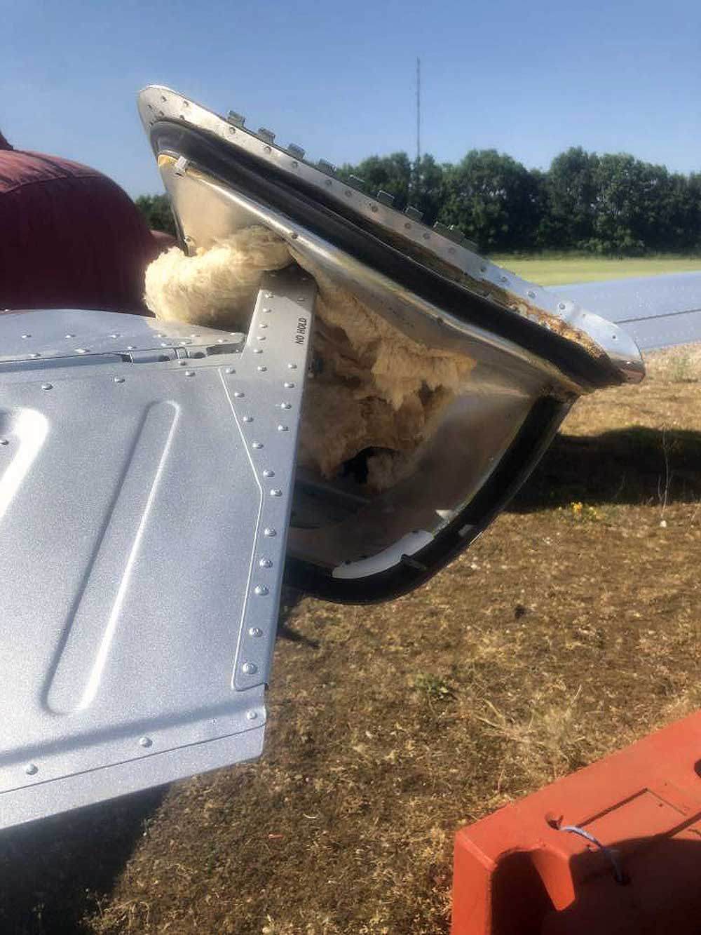

“Fifteen minutes into the flight the baggage hatch opens and breaks away from the piano hinge and it somehow catches on the leading edge of the horizontal stabiliser. The loose metal managed to wedge itself between the elevator fork and the main surface restricting free movement of flight controls.
The Mooney baggage door speared onto the elevator. Photos and video: Steve Le Van

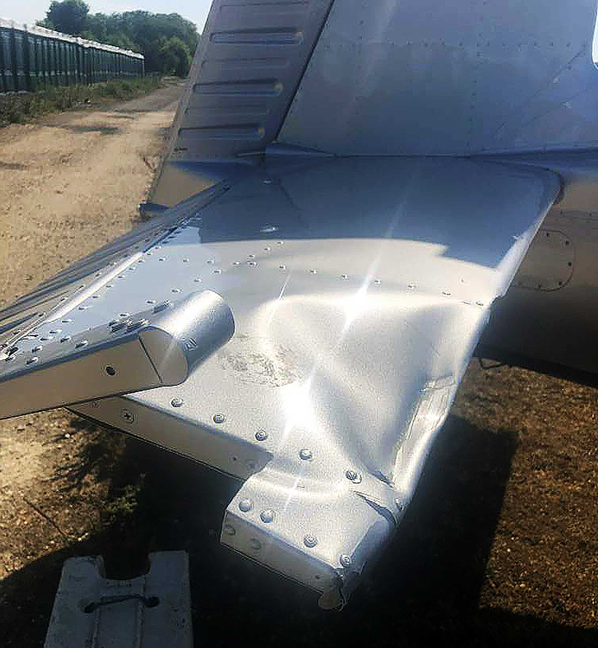

Damage to the Mooney’s tailplane – that’s a lot of force!
“Mooneys have control rods rather than cables connecting the flight controls and an articulating tail trim so although in the video the aircraft seems responsive, it needed huge pressure to hold level.
“The warping on the elevator, popped rivets and twisted stabiliser and sheared metal on the empennage just shows how much force was being applied.”
